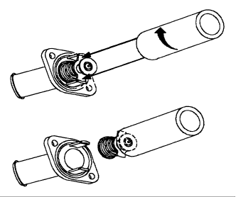

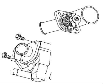

my dear old sw2 is pushing coolant out from reservoir cap when she gets about half hot on the gauge. i had water pump, t stat, and coolant hoses replaced back in Feb this year(Autozone cheap stuff is all i can find here in las vegas). can u email a diagram for removing A/C compressor (i'm hesitant to remove improper bolts/should entire bracket be unbolted or unbolt the compressor from the bracket?) so i can get at the thermostat? PLEASE.?

Hi marssandm, Welcome to 2carpros and TY for the donation REMOVAL
https://images.2carpros.com/forum/automotive_pictures/12900_t1_29.jpg

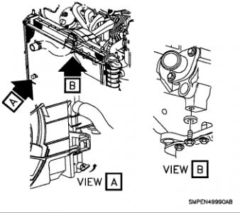

Drain coolant from the radiator and engine drain plug located at the right front of engine. Disconnect lower radiator hose at thermostat housing. Use Snap-on Tool HCP10 or 20 (or equivalent). Remove two bolts in water inlet housing.
https://images.2carpros.com/forum/automotive_pictures/12900_t2_6.gif
Remove water inlet housing and thermostat assembly. Remove O-ring. CAUTION: The O-ring gasket must be replaced whenever the thermostat housing is removed. NOTE: The thermostat element should not be removed if the assembly requires testing.

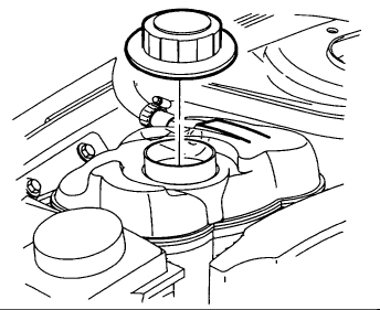

Install a new O-ring on the inlet housing: Install the thermostat and inlet housing into the cylinder block. Install the retaining bolts. Torque to30 Nm (22 ft. lbs.) . Close radiator drain plug and install cylinder block drain plug. Torque to35 Nm (25 ft. lbs.) . Install the lower radiator hose. CAUTION: The vehicle must be level when filling with coolant. Fill the system with coolant. Use only a non-phosphate ethylene glycol-base coolant, mixed according to the manufacturer's directions. Start engine. Fill the cooling system surge tank to the FULL COLD line after the engine has run for two to three minutes.
https://images.2carpros.com/forum/automotive_pictures/12900_t6_4.gif
Install pressure cap and check for leaks.
