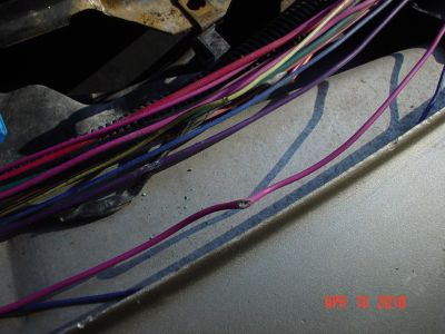

i noticed the daytime running light dashboard indicator flashing at me when i placed the car into gear. it comes on normal, then shortly afterwards flashes 7 or 8 times, pauses, then does it again a couple times, then shuts off. i found the right side hi beam not functioning in the daytime running lights function as well as during the normal hi beam operation. i've tested the bulbs and all is ok there. i did find an almost broken blue wire on the right side hi beam lead right near the plug to interface with the bulb, i striped that back a little and soldered and shrink wraped it up proper but still no 12 volts continuing back from bulb.. i checked the fuses for that side and all is ok with them. as a last ditch effort as i could not get any information to otherwise confirm or deny my assumption i replaced the daytime running lights module/relay.. still no right side hi beam nor running lights.. could there still be a broken wire in that circuit.. i guess i'd have to tear the harness and fuse/relay center apart enough to get to the other end of those leads to check i suppose.. any help will be most graciously appreciated..

Hi tcochuck,
Thank you for the donation.
The right side high beam gets its power from the DRL relay in underhood fuse block. It is an "A" relay, meaning power gets through when the relay is not activated and cuts off when the relay is energised.
If you do not have 12 volts at the RH high beam ( Dark/Blue wire) check the DRL relay.

With the DRL relay unplugged, if voltage is not available at one of the terminals, then you have a possible open circuit in the fusebox.

Sorry for missing out the part of the flashing DRL indicator. Possibly the control unit has detected a fault and trouble codes are stored. Get a scan done to retrieve the trouble code and let me know what it says.
The trouble code might not be related to the code and if there is power at the relay terminals, try bridging the terminals without the relay and test if voltage is available at bulb. If not, the output line from relay to headlight bulb is open.

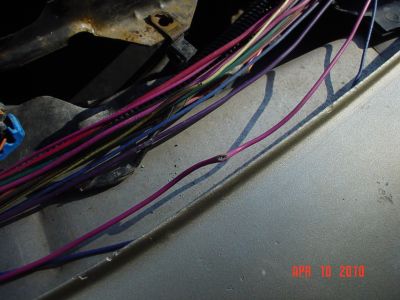

found the problem, the pink wire from the right side high beam was broken and buried further back on the headlight harness than the previous repair in the blue wire that was behind the right high beam. the insulation had gotten cut there and allowed water/moisture to get in there and corrode the wire in two. i also found a couple more chafed spots that i cut, striped, soldered, and heat shrinked/sealed. i had removed the wires from the loom a few days ago looking for other breaks but did not do a wire by wire examination.. oh well, that's why i get paid the big bucks for in the first place in what i do.. i repair $500 or $50,000 restaurant equipment and household appliances so I'm verrrryyyy familiar with electronics. that's why i was very clear in my explanation in my first post about flashes of dashboard indicator, etc.. i just do not work on cars any longer, don't usually have much time for it. i take it you didn't get to look at a copy of the wiring schematic for the lighting harness for my saturn before offering assistance?? you'd notice that the circuit is hot with +12 volts at all times, they switch the neutral quite often in these situations. key does not need to be on, nor headlights switched on.. kinda figured that flashing light thing in the first post would have meant something.. hmm, alas that's why i don't work on cars much.. not enough money in it.. lol..
