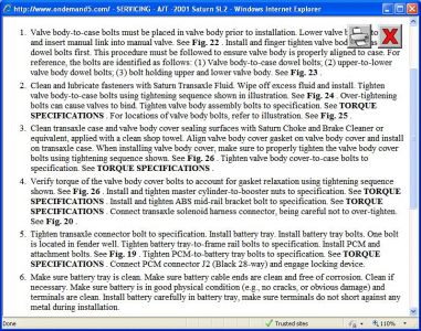

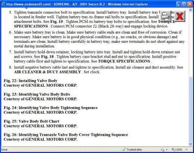

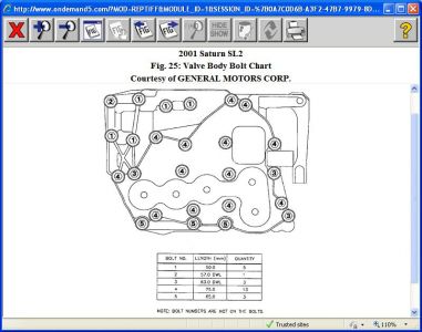

Torqued the bolts to 97 inch-pounds. Tighten one bolt on one side and then tighten the opposite one next. Is there a certain pattern you have to follow? Bought the valve body through Valve body Express and then Transtar Industries, Inc shipped it. I have an appointment tomo morning to get it scanned. Also today I could here with my window down, when I put it into D2 a whining sound and a few clicks were coming from the valve body. I know the manual Valve was inserted with the plastic clip facing towards the front of the car and then hooked back up the Manual valve link. Sure sounds like something is coming from that. Wondering if that could be my problem bc I never did hear that before. thanks again.

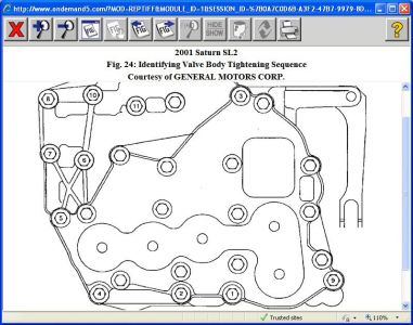

https://images.2carpros.com/forum/automotive_pictures/416332_2001_sl2_valve_body_installation_part1_1.jpg
https://images.2carpros.com/forum/automotive_pictures/416332_2001_sl2_valve_body_installation_part2_1.jpg
https://images.2carpros.com/forum/automotive_pictures/416332_2001_sl2_valve_body_bolt_postion_1.jpg
https://images.2carpros.com/forum/automotive_pictures/416332_2001_sl2_valve_body_bolt_tourqe_sequence_1.jpg
Theres the installation process,the tourqe sequence,and the bolt location.You have the right tourqe though.Did you get the dowl bolts in the right location?As far as your noise goes sounds like your transmission actuators are just engaging which they make noise when they do that perfectly normal.you could have gotten a bad valve body even i have gotten bad ones that were factory reconditioned even but were not there yet to say that.Let me know what you find.

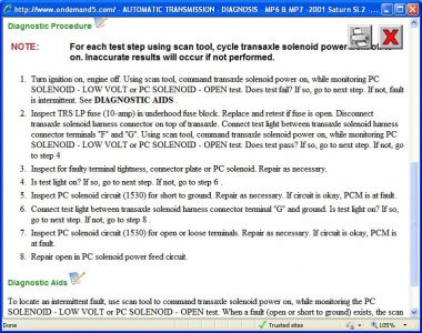

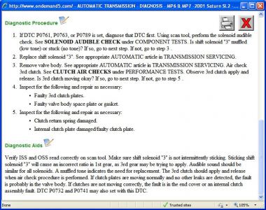

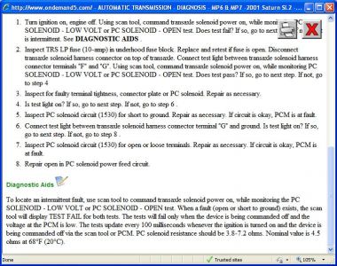

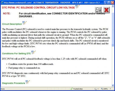

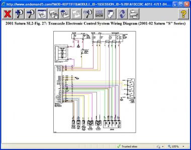

https://images.2carpros.com/forum/automotive_pictures/416332_2001_sl2_p0746_part1_1.jpg
https://images.2carpros.com/forum/automotive_pictures/416332_2001_sl2_p0746_part2_1.jpg
https://images.2carpros.com/forum/automotive_pictures/416332_2001_sl2_p0746_part3_1.jpg
https://images.2carpros.com/forum/automotive_pictures/416332_2001_sl2_transmission_wire_diagram_1.jpg
I dont know what code you have i just posted the trouble tree for code p0746 pessure control solindo low voltage so you could read about how it worked and kinda get an idea of how it works.I want you to check the trs Lp fuse in the underhood fuse box it wont have power you will have to visually inspect it.Thats your line pressure fuse.Also remove the connector to the valve body look at the back of plug comming off the engine harness its labeled with letters.Use it as a guide to find terminials F and G on the valve body connector bus plate take your ohm meter on 200 ohm scale and read the value across those two terminials it should be 3.8-7.2 ohms that will check your line pressure actuator electricialy.That doesnt make sense that they cant talk to your computer because supposedly your line pressure solindo is turned off never heard of that one.You need to get some codes out of your car though.You could have a problem with your wires going to your actuators even and that could have been your problem all a long and not your valve body.Iam not saying for sure but that is a possibilty.So did you try going to autozone just for a code scan?Let me know what you find.

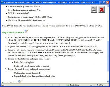

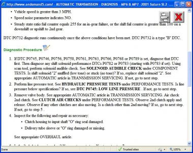

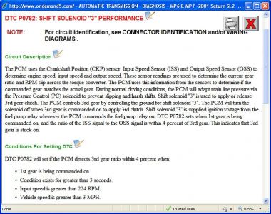

Made it to autozone and codes were P0732 and P0782. I havent been able to check anything else today bc of thunderstorms and I dont have a garage. From these codes where would you recommend that I start at? thanks again.

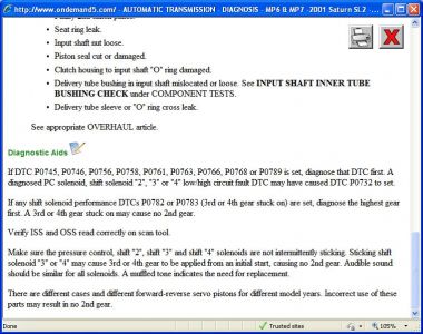

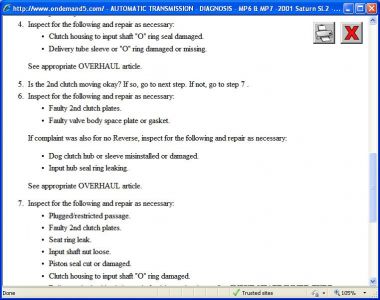

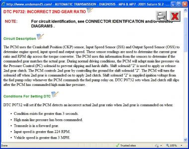

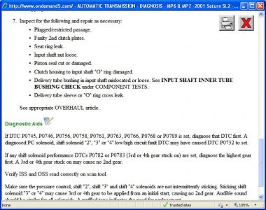

https://images.2carpros.com/forum/automotive_pictures/416332_2001_sl2_code_p0732_part1_1.jpg
https://images.2carpros.com/forum/automotive_pictures/416332_2001_sl2_code_p0732_part2_1.jpg
https://images.2carpros.com/forum/automotive_pictures/416332_2001sl2_code_p0732_part3_1.jpg
https://images.2carpros.com/forum/automotive_pictures/416332_2001_sl2_code_p0732_part4_1.jpg
https://images.2carpros.com/forum/automotive_pictures/416332_2001_sl2_code_p0732_part5_1.jpg
https://images.2carpros.com/forum/automotive_pictures/416332_2001_sl2_code_p0782_part1_1.jpg
https://images.2carpros.com/forum/automotive_pictures/416332_2001_sl2_code_p0782_part2_1.jpg
https://images.2carpros.com/forum/automotive_pictures/416332_2001_sl2_code_p0782_part3_1.jpg
Thats pretty sad autozone got codes but that shop couldn't.If you read the code p0732 it says that a 3rd gear solindo issue can cause the p0732 code.So start with the code p0782.The terminials you need for 3rd gear solindo on the valve body bus plate is A and B check it for ohms like i told you to check for the pressure control solindo.Let me know what you find.
