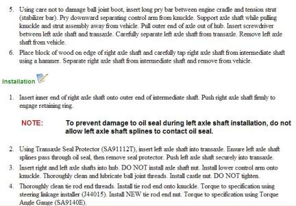

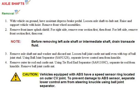

how do you replace front axles on 2001 saturn. I am pretty sure its the CV joints. i think it might be easier to change the front axles than just the CV joints. the price for parts is not that much different.

https://images.2carpros.com/forum/automotive_pictures/261618_Noname_1772.jpg
https://images.2carpros.com/forum/automotive_pictures/261618_Noname2_561.jpg
https://images.2carpros.com/forum/automotive_pictures/261618_Noname3_216.jpg
Feb 25, 2010 at 12:39 PM
