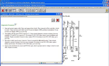

https://images.2carpros.com/forum/automotive_pictures/416332_1999_SL2_code_P0722_1.jpg
I couldn't find any code P0522 listed for your car i would double check and make sure what the actual trouble code was.I also emailed you the trouble tree for P0722.
