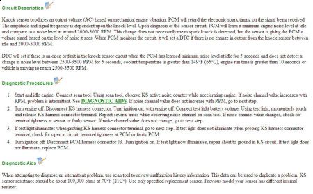

By looks of what we have I would go after the knock sensor code.
https://images.2carpros.com/forum/automotive_pictures/30961_zsat_1.jpg
We can build theories that will say the knock sensor code is a symptom or a source of the code and or performance. The Knock Sensor resistance should be about 100,000 ohms at 70 F. If you can't read the pic, I can send it to you. Not sure what all got washed, but I hope the pcm didn't get wet.

We dont need to worry about the PCM having gotten wet, they didnt move the PCMs to the engine compartment until 2000. This one should be under the driver's dash.
The carbon clean-out tip was right on. The carbon that was easy to get at clogging the secondary air tube into the exhaust manifold was cleaned out. Some other easy to clean items were cleaned. Also the knock sensor terminal was cleaned. Doing this cleared all of the codes except the quad driver code.
The car runs better but still stumbles during mild acceleration once warm, it occasionally sounds like it backfires, and it occasionally stalls when shifted into reverse. One thing I need to mention is that the quad driver check list I went through above was to a '92 Saturn SL. I couldnt find anything more applicable. This car was manufactured 6/98 but was sold as a 99 so Im not sure what that was about but I digress. We're down to the P1670 quad driver code which showed up after the engine wash. How do I determine what is causing this code?
