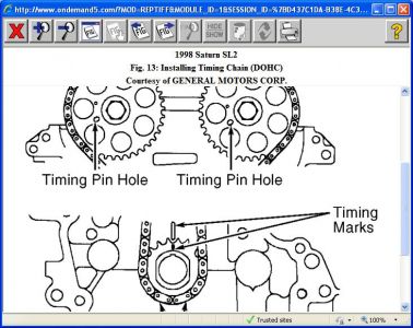

do you have to take the harmonic balancer off to check the mark on the bottom i was assumeing it jump timing so it might be the valves thanx for the info ill be in touch with the diagnose on the timing tonight
Aug 23, 2010 at 5:15 AM
SATURNTECH9
  • 30,869 POSTS
https://images.2carpros.com/forum/automotive_pictures/416332_1998_SL2_timming_marks_1.jpg
Line up the the hole's in the cam sprocket's when there lined up correctly you will be able to put a 3/16" drill bit threw the hole in the cam and into the hole behind in the head.AS far as bottom mark goes on the crank sprocket you can't see those mark's without taking the front cover off.Line up the mark's on the front cover and the crank pulley.Don't worry about the colored link's that is for setting the timing when you replace the chain or put the chain back on.You could have some bent valve's causing the low compression.
