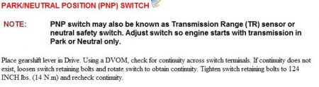

Installed new switch. Need to know how to adjust new switch and cable.
