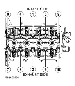

I own a 1996 saturn sl2 and i'm trying to remove the head of the engine to check out the head gasket and the cylinder walls to make sure they're ok. Long story short the engine started making a loud knocking sound the other day, then it erupted in smoke and lost almost all power and then stalled at every stop. I know it's probably shot to hell and back but i would still like to check. I've removed the valve cover, timing belt, camshafts, a/c compressor, exhaust manifold, and the head screws in and around where the valves are, i've removed the belt from the side of the engine, and disconnected the battery terminal and took out the tubing from the throttle body. Even after i've done all that it still won't come off... can someone please give me a list of all the things i need to remove to get the head off? Thank you ahead of time!

INTAKE MANIFOLD Removal Disconnect negative battery cable. Drain coolant. Remove air cleaner assembly. Remove PCV valve. Release fuel pressure. Disconnect fuel supply and return lines. Disconnect throttle cable from throttle body. Remove throttle cable bracket. Disconnect electrical connectors and hoses as necessary. Remove support bracket between intake manifold and engine block. Remove accessory drive belt. Remove power steering pump, and position it aside (leave hoses attached). Remove intake manifold nuts. Remove intake manifold. Inspection Using straightedge and feeler gauge, check for warpage at gasket surface. If warpage exceeds specification, replace intake manifold. EXHAUST MANIFOLD Removal Raise and support vehicle. Disconnect exhaust pipe from manifold. Lower vehicle. Remove A/C compressor (leave hoses connected) and rear bracket. Disconnect oxygen sensor connector. Remove oxygen sensor (if necessary). Remove exhaust manifold nuts. Remove exhaust manifold. CYLINDER HEAD CAUTION:If coolant becomes contaminated with oil, cooling system thermostat will fail. If oil is found in cooling system, thoroughly flush system and replace thermostat. NOTE:Remove cylinder head with intake manifold, exhaust manifold, throttle body, fuel rail, and fuel injectors attached. Removal Disconnect negative battery cable. Drain coolant. Remove air cleaner assembly. Disconnect accelerator cable. Disconnect electrical connectors and hoses as necessary. Release fuel pressure. Disconnect fuel lines. Remove front cover and timing chain. Using a 6-point socket (a 12-point socket will round off bolt heads), uniformly loosen cylinder head bolts in reverse order of tightening sequence, in several stages. Remove cylinder head.

Ok first off thank you for responding i really appreciated it. I followed your instructions to the t, but the head still won't come off... i know sometimes it can be glued or stuck together after years of usage so i tried hitting it with a block of wood and a hammer towards the firewall, towards the headlights, and i even eventually tried using a crowbar to pry it straight up in case there were sleeves in the head bolt holes. Nothing worked and i still haven't been able to get the head off... any other advice?
