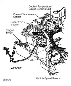

https://www.2carpros.com/forum/automotive_pictures/416332_coolant_temp_sensor_19911995_2.jpg
ok so u only had a code 12 when u flashed the codes out?no other ones?like if u checked now u might have some other ones.sounds like its running differnly now?i wouldnt have changed ur throttle postion sensor they hardly ever go bad.whats been throwing me off is u said it ran good before u changed the valve cover gasket.sounds like this might have been happening before maybe it got worse?i posted a diagram of where ur coolant temp sensor is its the bottom one in the diagram and on the head.it could be causing ur problem there like 10 easy to change.a bad one will cause erratic idle dieing surging overheating all kinds of things and its pretty common for them to go bad.make sure the engine is cold u will lose coolant.make sure u inspect its connector if its corroded u will need to replace the connector.also make sure u get a brass tipped one the plastic tipped ones crack and leak into the connector.thats ur best bet right now.let me know what u find.
