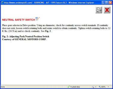

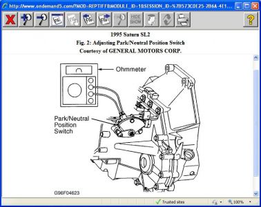

i changed the safety neutral switch and now my car will not change gears on it own when i get up to 35 it will stall like it is in neutral

How did your car shift before you changed the selector switch?Why did you change it?Did you adjust it with a ohms when you changed it?Let me know.

i changed it when i was having problem with my car not wanting to start. and not i did not adjust it with ohms . where do adjust it at

Here's all the information you need to adjust your switch.Let me know if you have anymore problems and need some more help.
