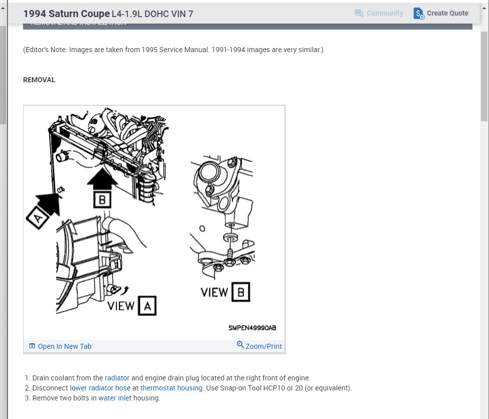

Where is the thermostat?
Nov 23, 2009 at 10:40 PM
The thermostat on this engine is in the lower radiator hose.
Here is a guide that will talk about how they work which is good info to help explain possible issues:
https://www.2carpros.com/articles/how-an-engine-thermostat-works

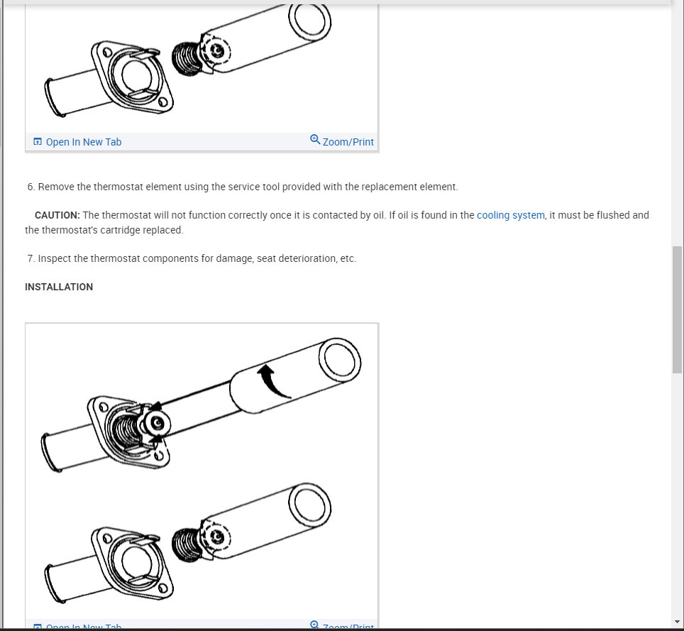

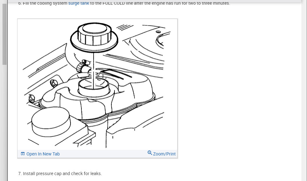

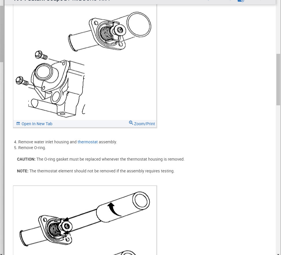

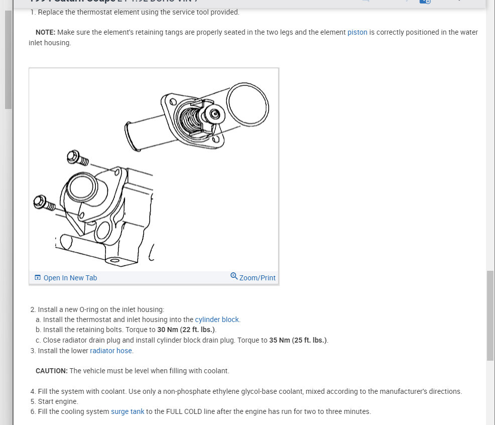

If you want to replace it, please follow the process below for instructions on how to replace them.
Please let me know if there are other questions.
