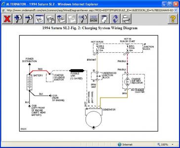

https://images.2carpros.com/forum/automotive_pictures/416332_1994_sl2_alternator_wire_diagram_1.jpg
I posted a alternator wire diagram for you.You could have gotten a bad new alternator did you have them test it before you bought it?I had them do that before and the clerk got mad at me for asking to test it.After the third alternator tested bad in a row i was laughing pretty hard at him the last one number four tested good.What i want you to do is get your volt meter out key on engine off check your ign3 and ign1 fuse's in your under hood fuse box if there good then go down to your alternator and check that post on the back of the alternator for battery voltage.Then unplug the connector on the side of the alternator at the terminal end check the brown and white wire for battery voltage.If all that check's out then take out your alternator and have it tested where you bought it.Let me know what you find.
