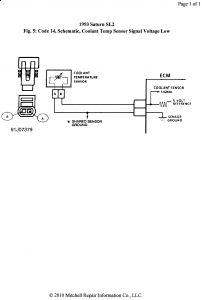

I have replaced the temp coolant sensor, now the cooling fan runs continuously, and it has engine codes, 14, 15, & 45 and the low coolant light is on, but I refilled the system after the sensor. On the brighter side of things, even though it has a code 45 it isn't flooding and is idling below 1k rpms. I took it for a test drive and when I push the clutch in at a stop the engine tries to slowly die out. Please help again.

https://images.2carpros.com/forum/automotive_pictures/416332_img013_1.jpg
this the only pic i could get to upload on here right now.send me ur email adress via private email on here and i will send u the rest of the info.code 14 is coolant temp low.sensor,signal voltage low.code 15 is coolant temp.sensor,signal voltage high.from what u describe i would look into the code 15 because ur fan runs all the time and it sounds like ur engine is starving for fuel now.to set a code 15 the computer thinks ur engine is running above 265 f have u tried just plugging in the old sensor without installing it to see if ur fan turns off.maybe u just got a bad sensor.or unplug the sensor and see if ur fan turns off.let me know what u find.

Thanks for the help, I did take the new sensor back and exchanged it and everything is running like...well as new as can be expected. It must have been a bad sensor.
