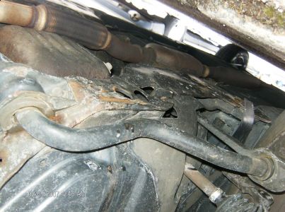

ok finally managed to get these pictures. Nothing else seems to be damaged at all just the subframe and it doesn't seem to be that bad.
https://images.2carpros.com/forum/automotive_pictures/491004_HPIM0897_1.jpg

From ur pic it's kind of hard to tell what it looks like but if it's bent bad enough to run down the road like u said then it needs to be replaced if u replace u will need a engine support like I was telling u about or the engine and transmission will come down with the frame.let me know how it goes.
