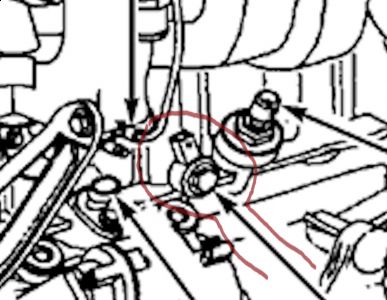

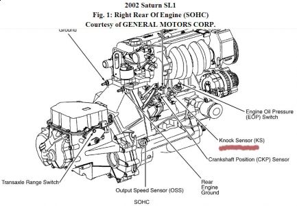

Carbon build up, timing, low octane fuel are some possiblities. First I would check the computer for codes to see if any are present before any part replacement. Knock sensor:
https://images.2carpros.com/forum/automotive_pictures/30961_wasat1_1.jpg
https://images.2carpros.com/forum/automotive_pictures/30961_wasat_1.jpg
