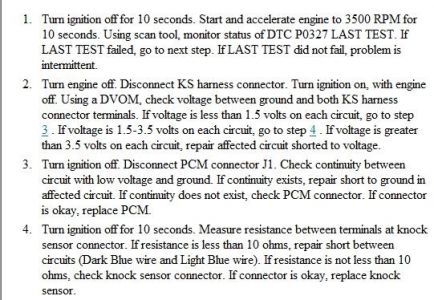

Yellow light display indicating code PO327. I replaced knock sensor; cleared code, and within a mile, yellow light came on again. What is wrong? What must I do to fix? Thanks.

Thank you for your reply; I'll try it tomorrow. Space is so confined, I hope I can see/find and fix the probable short. Any additional suggestions or shortcuts are welcome.
