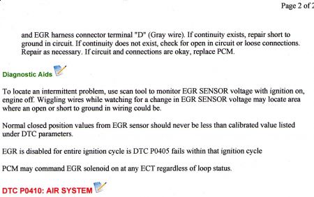

I currently have check engine light on..went to Advanced Auto Parts and the code p0405 egr flow sensor a circuit low input came up. The salesman suggested cleaning it first rather than selling me a new one. Once this was done my car now has a stalling sensation. If we remove the connection harness of the EGR valve when the car is running and then put it back on within 30 seconds it cures the problem of bucking and stalling. I just recently replaced the O2 sensor with a bosch product. The old sensor had failed too..but the new one does'nt look the same. Could the O2 sensor be causing the misfires?

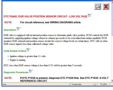

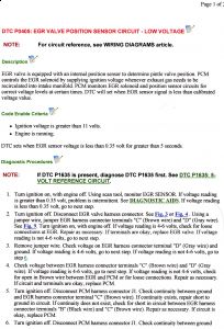

i wouldnt worry about the o2 sensor causing missifires its going to look differnt its a differnt brand and after market.i think ur on the wrong track here here is the trouble tree for the p0405 let me know what u find.
https://images.2carpros.com/forum/automotive_pictures/416332_2001_p0405_1.jpg

sorry that was a messed up copy of that trouble tree here is a better one
https://images.2carpros.com/forum/automotive_pictures/416332_2001_p0405_part_1_1.jpg
https://images.2carpros.com/forum/automotive_pictures/416332_2001_p0405_part_2_1.jpg
sorry about that.
