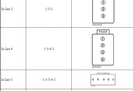

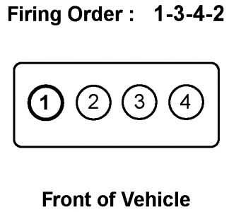

Wire and plugs order

Here you go

Firing Order 1-3-4-2
