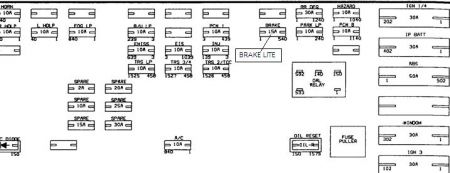

What and where do i check to fix this problem. I looked at the booklet about fuses under hood or under dash didnt see anything that said tail lights or brake lights. Thank you.
It was the fuse and one blown out light. thank you.

if u go in the under hood fuse box theres a fuse marked brake light check and see if the fuse is good and has power.let me know what u find.

https://images.2carpros.com/forum/automotive_pictures/170934_underhood_brake_fuse_1.jpg
The brake fuse is in the underhood fuse box, sorry if the picture isn't readable. I did magnify it. Not only check the fuse, use a testlite, see if fuse circuit is hot. A place to start.

thanks for the pic jdl123 that will help them find the fuse better.
