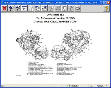

https://images.2carpros.com/forum/automotive_pictures/416332_2001_coolant_temp_sensor_2.jpg
i posted a diagram of where ur coolant temp sensor is when they go bad they cause no starts flooding when trying start over heating surging bucking all kinds of stuff.u could try replacing that there only like 10 becareful u will loose coolant if u replace it make sure u get a brass tipped one the plastic tipped ones crack.also check the connector they get corroded and turn green.if its corroded then u will have to replace the connector.u could also have a plugged cat does the car run good till it warms up then will it bog down and have no power.if so thats the usual symptoms of a bad cat.the exhaust shop would have to perform a back pressure test on ur car to see if it was that though.let me know what u find.

so.....i did what you told me and replaced the cooling sensor and conector and it didn't do nothing to the car, every time i press the gas after 30mph it gets the hiccups and when i stop on a light it hiccups like choking it feals like it wants to turn off! but only when i put it on drive when is on park or neutral it stays on 1000rpms. should i perform a back pressure test or should i just replace the o2 sensor???

so was the connector corroded?i hope so because i only wanted u to change the connector if it was corroded.the o2 sensor is not causing this it would set a code and i have never seen a bad o2 sensor make a car run like this.i would be checking back pressure and fuel pressure right now.how does it run cold good or the same when its hot?let me know what u find.
