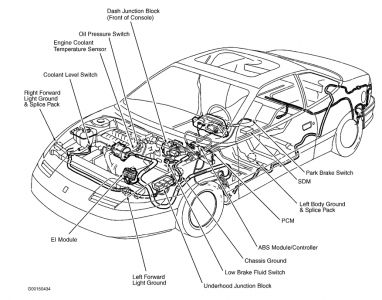

hi my tem gauge on my dash will seem to work fine, then it jumps to almost in the red, then the fan will kick on for 2-5 seconds, then the gauge will all of a sudden drop all the way down to nothing and not work at all...i replaced the thermo in it, and it is still doing it...any ideas?

check for faulty engine coolant temp. (ECT) sensor

do you happen to know how i can tell if it is bad, and where it is located?
Jun 10, 2010 at 9:33 PM
BLUELIGHTNIN6
  • 16,542 POSTS
it is located on the rear of the engine, pic below
https://images.2carpros.com/forum/automotive_pictures/261618_Noname_2333.jpg
With an ohmmeter just connect to the 2 contacts while it's unplugged, or with a voltmeter you can check the outgoing voltage compared to the reference (input) voltage of 5 volts, if you connect some special jumper wires that allow access without puncturing the wires. Let me know what results you get and I'll post back wether it is within specs or bad.
