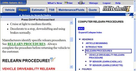

how do i reset my computer on my saturn 96 sl-1 two new oxygen sensors were replaced by my mechanic and the codes reset but i took the car through the air test lane and they told me to drive it more because my computer did not reset yet.i already put on a hundred miles on the car and it still did not reset what do i have to do to get it to reset, driving me crazy?
Mar 29, 2010 at 3:34 PM
  • 75,988 POSTS

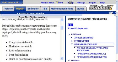

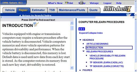

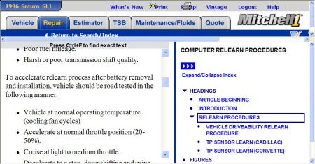

Computer relearning procedures:
