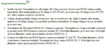

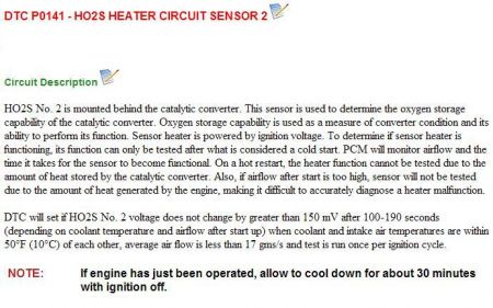

Service Engine Light came on 1996 Saturn. Ran preliminary diagnostics and received P0141 code. What is the problem and possible solution. Code cleared once tool was placed on ODB port.
Jun 23, 2009 at 11:48 AM
BLUELIGHTNIN6
  • 16,542 POSTS
Most likely just need a new O2 sensor..details about this DTC are below..
