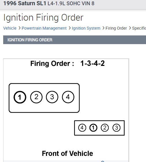

What is the piston order from left to right?
Tuesday, August 10th, 2010 AT 2:43 PM
SQM
MECHANIC
6,383 POSTS
The firing order for this vehicle is 1-3-4-2.
I have attached diagram for your reference.
