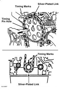

i just re-built the engine and was being cautious as not to turn eather the crankshaft or camshaft when oppps i turned the camshaft but did not notice how much now its out of time between the two how do u fix this
Mar 6, 2009 at 10:21 AM
BMRFIXIT
  • 19,053 POSTS
Here is the timing marks need to set the marks as you see
https://images.2carpros.com/forum/automotive_pictures/99387_Graphic1_237.jpg

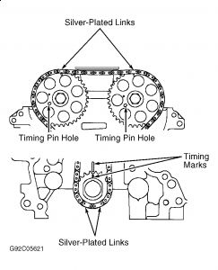

ok i dont know if it maters but i only have one camshaft
Mar 7, 2009 at 1:46 AM
BMRFIXIT
  • 19,053 POSTS
https://images.2carpros.com/forum/automotive_pictures/99387_Graphic1_240.jpg
