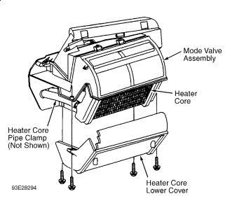

Sorry but not much info on heater core removal other than the below.
HEATER CORE
Removal
Drain cooling system. Disconnect heater hoses. Remove lower trim panels from below A/C-heater control panel. Remove lower heater duct. Remove heater control cable. Remove heater core side cover screws and side cover. Remove lower heater core cover screws and pipe clamp. Remove lower cover.
See Fig. 5 .
https://www.2carpros.com/forum/automotive_pictures/248015_5_44.jpg
Remove heater core bracket and heater core.
Installation
To install, reverse removal procedure. Fill cooling system. Ensure control cables are properly adjusted.
