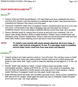

1994 Saturn SL1 4 cyl Front Wheel Drive Manual
How do you go about pulling the wiper motor out
Feb 8, 2010 at 2:46 PM
SATURNTECH9
  • 30,869 POSTS
https://images.2carpros.com/forum/automotive_pictures/416332_img010_1.jpg
theres the info u needed good luck.
