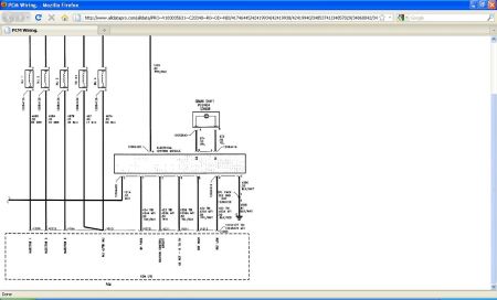

do you know if the dk blue wire (pulse ground) it may be black goes directly to the ecu and if so I could probe at that connection where the wire comes out and it should pulse which I could then jump....but probably I'll need to replace the ecu.... thanks again KD58 (any chance of getting a diagram of the ecu showing where that wire should be?)

https://images.2carpros.com/forum/automotive_pictures/416332_1994_SL1_injector_diagram_1.jpg
Yes the light blue wire goes straight to the ecm and that is a pulsing ground while cranking.I would take a ohm's meter and go from the terminal to the injector to the terminal of the ecm it should be 2 ohm's or less.I also emailed you the diagram.

Louie, you're my new best friend...the principle is surely the same but mine is a single injector with a dk. blue (or black) wire?????? thanks KD58 (where are you located and how will I know that YOU will get any $ )

If you look a little closer it show's both the four injector and single injector that's why it show's 5 injector's one of those injector's is labeled TBI which is throttle body injection which yours is.If you donate under the user name you used to ask the question with i will get the money i'm suppose to get when you donate no worries there.

thank you louie...I have 2 ohms from ecu pin to injector so does that mean it is for sure the ecu???and should I pull that wire at the pin and look for anything specific? getting closer KD58

Nothing in life is for sure lol.But if you rule out the wire and terminal tightness then all your left with is the computer.If your getting 2 ohm's from terminal to terminal then there is no point in removing the wire from the connector.Now your left with terminal tightness and the computer.

Louie...just a note to say thank you for guiding me through the diagnosis...I just replaced the ecu and it runs fine...was hoping for a different solution (obviously) but at least it is fixed...thanks again...going to send $ now kd58 in good ol Boring Oregon
