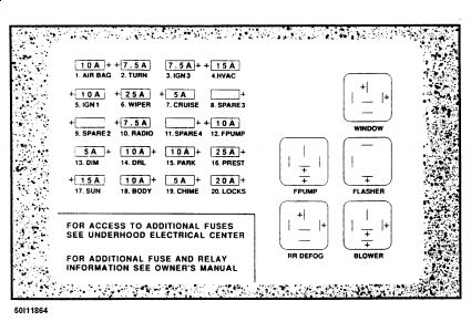

My break lights stopped working. The left right and center one. I checked the bulbs and they are ok. I looked for the fuse and see only one 15 amp blade fuse under the hood. Is there another fuse im missing here? All other lights work including the tail lights.
Can anyone help me with this?

Instrument panel fuse block is located under the dash panel ,left of steerin column. Fuse # 2 its 7.5Amp(brown) check brake light switch

Where is the brake light switch?
The 7.5 fuse #2 is the turn signal according to this diagram which is my fuse panel. Is this the brakes fuse also. I CHECKED any ways and is ok.
I did check under the hood and there is only one blade fuse 15 amp and i checked. I replaced too make sure also.

brake light switch is located top of brake paddle

I now no i need too take this switch off, but how. It looks like they built the switch around the car.
I cannot get my hands in there, There is a fastner on a bold but what tool do i need to replace this?
