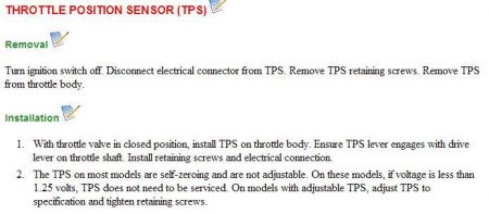

How do I replace the Throttle Position Sensor, and where is it?

It's under ur air box mounted to the side of ur throttle body injection with a couple of screws.why are u changing it they hardly ever fail did u get a code or is it running bad.it the last thing I would check or replace on that car unless something Led me straight to it.let me know.

TPS is located on throttle body assembly..
https://images.2carpros.com/forum/automotive_pictures/261618_Noname_1748.jpg
