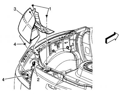

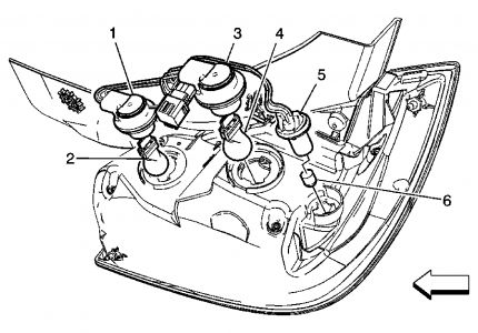

LEFT REAR TURN SIGNAL HAS TWO BULBS THAT FLASH WHEN TURNING .ONE IS BURNED OUT. BUT I CANT FIGURE OUT HOW TO TAKE THE HOUSING APART TO CHANGE IT

Hi JDPRIL20, Thank you for the donation. You need to remove the taillamp assy to replace the bulbs.
https://images.2carpros.com/forum/automotive_pictures/192750_TaillampSaturn07Sky_1.jpg
TAIL LAMP REPLACEMENT Preliminary Procedure: Open the rear compartment lid in order to access the tail lamp screws. 1 Tail Lamp Assembly Screws (Qty: 2) Tighten: 2.5 N.m (22 lb in) 2 Chassis Electrical Connector Tip: Lift the tail lamp in order to disengage the retainer clips then disconnect the electrical connector. 3 Tail Lamp Assembly Tip: Transfer the bulb into the new tail lamp. 4 Quarter Filler Panel Nuts (Qty: 2) Tip: Ensure the quarter filler panel nuts are not damaged. Replace if damaged.
https://images.2carpros.com/forum/automotive_pictures/192750_TaillampSaturn07Sky02_1.jpg
TAIL LAMP BULB REPLACEMENT 1 Stop, Tail and Turn Signal Bulb Socket Harness 2 Stop, Tail and Turn Signal Bulb Tip: Pull the bulb straight from the socket in order to remove. 3 Stop, Tail and Turn Signal Bulb Socket Harness 4 Stop, Tail and Turn Signal Bulb Tip: Pull the bulb straight from the socket in order to remove. 5 Rear Side Marker Lamp Bulb Harness 6 Rear Side Marker Lamp Bulb Tip: Pull the bulb straight from the socket in order to remove. Page 1 of 1 LIGHTING -2007 Saturn Sky 9/7/2008
