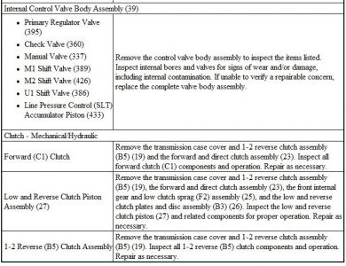

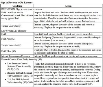

Hi Billy, Thank you foe the donation. What model Saturn is it? Ion, Vue or others? Here are possible causes for no reverse.
https://images.2carpros.com/forum/automotive_pictures/192750_NoReverse03VueFig01a_1.jpg
https://images.2carpros.com/forum/automotive_pictures/192750_NoReverse03VueFig01b_2.jpg

When the vehicle is cold, it gets reverse. When run, it does not get reverse. It has tremendous pickup from 60 to 80MPH with no slipping.

Hey. The electrical controls are the Line Actuators, Line actuators are controlled by PCM. Line actuators (duty-cycle type) open or close valve body ports inside the valve body. PCM controls line pressure with (duty-cycle type) line actuator to regulate transaxle line pressure for smooth shifting of transaxle does the vehicle have any fault codes stored on the PCM (transmission codes) .. From your description of the fault it is not an electrical fault on the transmission .. as reverse works untill the transmission gets hot .. then reverse is lost altogether .. I'm guessing the reverse clutches are bad .. the only way to check this is to remove the transmission and break it down on a bench .. it could need an updated valvebody .. but again the only way to check this is to breakdown the trans and check all internal parts !! Hope this helps
https://images.2carpros.com/forum/automotive_pictures/266999_AAA2_1005.png
AS a side note .. you do not need to remove the motor to get the transmission out ... let me know if you need removal assistance !
