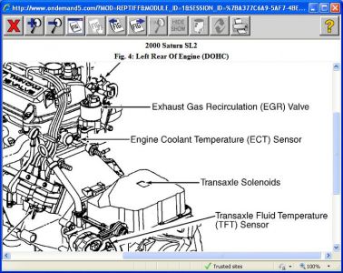

Today when I started it, the idle dropped low at curb idle. I'd say about 300? It's never done that either. And if I give it a shot of gas, it kind of bogs at the top of the rev.(At idle)
Saturday, August 7th, 2010 AT 8:41 AM
SATURNTECH9
  • 30,869 POSTS
https://www.2carpros.com/forum/automotive_pictures/416332_2000_sl2_coolant_temp_sensor_3.jpg
On your car most of the time it won't set a code if the crank sensor is bad.Your last symptom you described that could be a bad coolant temp sensor.They cause all kind's of problems no start's stall's overheating and you wouldn't know it because the gauge will read lower then normal because the coolant temp sensor's end up reading like 30-40 degree's below actual temp.Very common for them to go bad.There only 10 if you change it make sure you get a brass tipped one the plastic tipped one's crack.Also i would inspect the connector going to it if it's corroded it will have to be replaced as well.I know your next question will be where is the coolant temp sensor so i posted a diagram of where it is.Also if you change it make sure the engine is cold and you will loose coolant.

Yeah, I replaced the cts about 4 months ago as routine maintenance. I replaced the crank sensor today and so far so good. The one that was in it had a couple little cracks in it. Nothing I would see as terrible, but maybe with the heat oil got in and corroded the wires. Dunno. Lol
