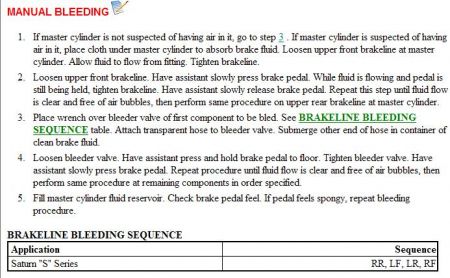

2000 Saturn Sedan 6 cyl Automatic
I just replaced rear rotors and pads...Made mistake of disconecting brake line. after all back to "normal" the brake pedal goes to floor. I pump break, works after pumping, then goes to floor again. Do the breaks need blead?..I don't know how to do it, any help woul be great. Thanks so much.

https://images.2carpros.com/forum/automotive_pictures/261618_Noname_1253.jpg
