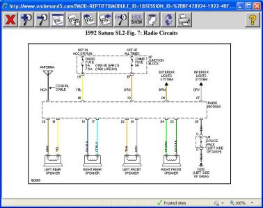

i want to change my radio but i need electrical schema to change it.

There you go.
