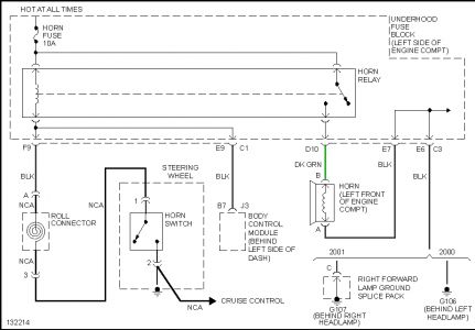

my horn does not work, but if you put power directly to
it it works, we need to test the wires in the steering wheel but we need to know what color they are, we do not want to accidentally set the airbag off. can you tell me what color they are or where i can find a wiring diagram.thanks, Matt

https://images.2carpros.com/forum/automotive_pictures/261618_Noname_2180.jpg
