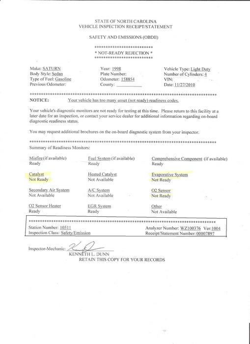

My 1998 has the same two "not ready" codes (plus a third Evaporitive System not ready) which is causing it to fail inspection. It would pass with two codes, but not three.
I drive only about 5-8 miles a day in town. How can I reset these so it will pass?
