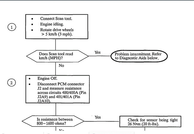

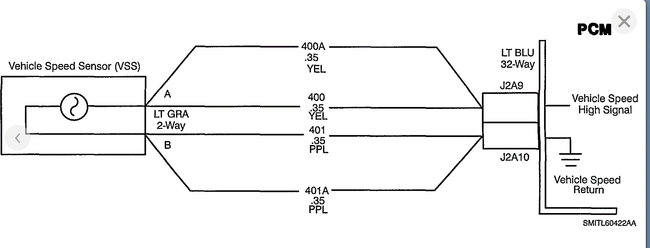

I took my car for an oil change about a month ago and then went to get an inspection sticker. the car did not pass because the computer was somehow cleared. they told me to drive it for a week and return it should be ready. I have been going back weekly for the kast 4 weeks and it is still not ready. Also somethings that had been ready the week before were not ready the following week. No one has touched my car but me. the only thing I have done is when I put gas in I zero out the mile counter to keep track of my mileage. Does this have anything to do with it? I would appriciate any help! Thanks!

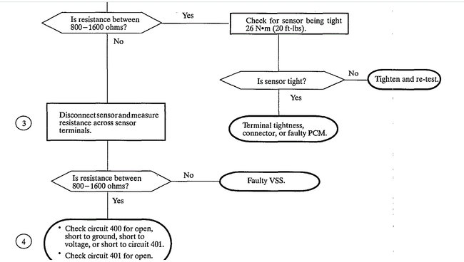

Sounds like a plan. I attached a vss wiring schematic and flow chart. Let me know what you find.
