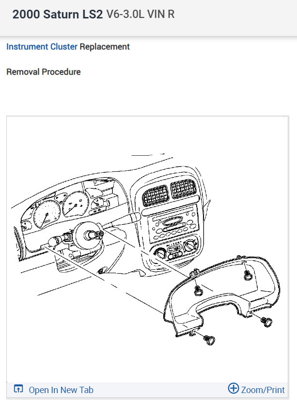

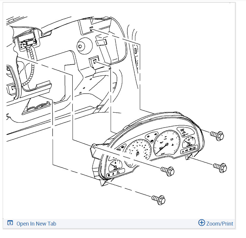

My Saturn SC1 does the same thing. If I remove the Body & Body Comp 10 AMP fuses with the battery connected and the engine off and reinstall the fuses, everything works when I go to start the car. The next time I go to start the gauges work or they may not and I half to reset the fuses again. It's like a relay somewhere is tripping and the fuses resets it.
Jun 2, 2024 at 10:38 AM
  • 55,433 POSTS
If all the fuses are good it sounds like the instrument cluster itself has gone bad. I would search google or ebay for a rebuilt or used unit and install it. Here is how, check out the images (below). Please let us know what happens.
