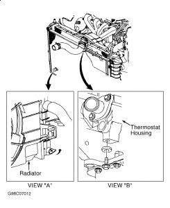

1998 Saturn SC2 water pump replacement
1998 SATURN SC2
ALDAZRU
Engine Cooling problem
1998 Saturn SC2 Automatic
Is there instruction manual available
May 24, 2009 at 2:20 PM
BMRFIXIT
  • 19,053 POSTS
1.9L 4 cyl VIN 7 & 8 Drain coolant. Remove accessory drive belt. Raise and support vehicle. Remove right front wheel and splash shield. Remove water pump pulley bolts. Remove water pump bolts and pump. Pulley and pump are removed as an assembly. T o install, reverse removal procedure. Use NEW gasket. Tighten bolts evenly in sequence to specification ***************************************** need manual CHECK IT @ https://www.2carpros.com/kpages/auto_repair_manuals.htm
