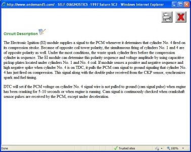

#1 and #4 cylinders not firing. Thought it was the coil (since there are 2 of them) and it did not fix the problem. I switch the coils only to have the same results of #1 and #4 not firing. I then replaced the module hoping that it was the problem. Well..it did not fix it. I am not very familiar with Saturns ( I was a Honda Tech) so I do not even know where the PCM is located. Is the PCM the next thing to replace?
I am going to borrow an OBD to pull the codes later, but if anyone has experienced this delima, I would appreciate any help!

got plenty of compression. I got a code PO340 - but this does not have a cam sensor. So I believe it is the result of the misfire, not the cause.

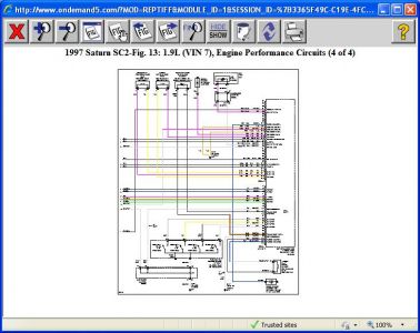

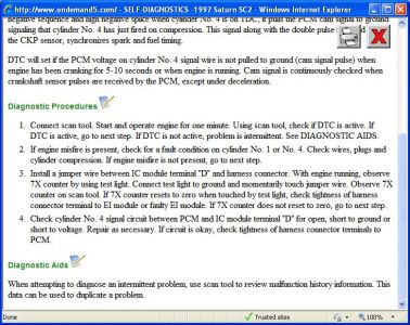

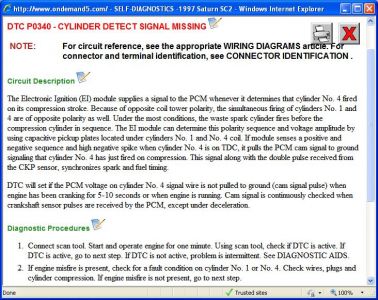

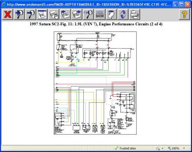

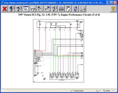

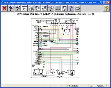

https://images.2carpros.com/forum/automotive_pictures/416332_1997_sc2_engine_performance_wire_part1_1.jpg
https://images.2carpros.com/forum/automotive_pictures/416332_1997_sc2_engine_performance_wire_part2_1.jpg
https://images.2carpros.com/forum/automotive_pictures/416332_1997_sc2_engine_performance_wire_part3_1.jpg
https://images.2carpros.com/forum/automotive_pictures/416332_1997_sc2_engine_performance_wire_part4_1.jpg
https://images.2carpros.com/forum/automotive_pictures/416332_1997_sc2_p0340_cicurit_description_1.jpg
https://images.2carpros.com/forum/automotive_pictures/416332_1997_sc_p0340_part1_1.jpg
May 6, 2010 at 3:24 PM
SATURNTECH9
  • 30,869 POSTS
https://images.2carpros.com/forum/automotive_pictures/416332_1997_sc2_p0340_part2_1.jpg
i would follow that p0340 trouble tree i posted for u that looks like the problem ur 1 and 4 signal to ignition module.i also posted wire diagrams and circuit description.let me know what u find.

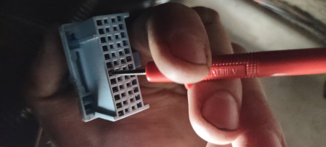

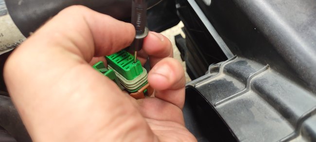

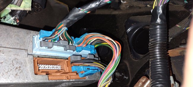

METALLICGREEN97
I just had this same issue on my car, check the continuity of the wire going from the b7 socket of the j2 connecter on the PCM to the E socket of the ICM connector. If the wire has continuity, then I believe that leaves only the PCM as the possible faulty part if you've already proven the ICM is good or is brand new and all the other components in the system ie. Crank sensor, ignition coils etc. If I'm wrong here please correct me. (note the j2 connector is the shorter light blue connector with exposed wires and the b7 pin is on the bottom row seventh from the left with the clip at 12 o clock) in my case the PCM is bad.
Sep 15, 2021 at 6:54 AM
