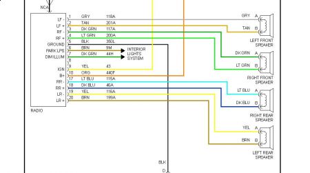

i have hooked up a stereo and have a green wire and brown wire and naw dash lights trying to figure out were theese wires need to go
Apr 21, 2009 at 6:15 PM
  • 75,992 POSTS
It goes to the interior lights dimming/park lights see below
https://images.2carpros.com/forum/automotive_pictures/12900_radio_1.jpg
