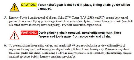

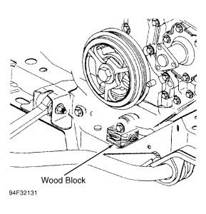

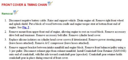

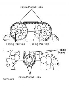

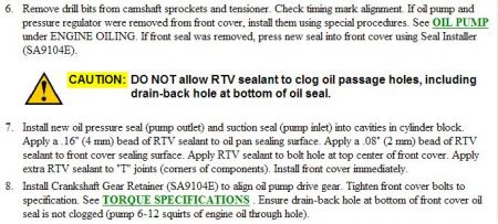

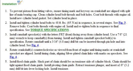

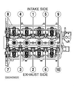

I have a 1.9 liter engine in my 2 door. i have a dead miss in number 4. I ran a compression test on munber 4 and I am only getting 20lbs. on number 4. the spark plug is wet from gas. there is no findings of oil on the plug. I think that it might be a burnt vavle. I am looking for info on setting the timing chain. I need to know where and how to set marks on cam gears and on the crack shaft. any info on this matter is greatfulley welcomed. thanks gmonkey1969

Timing chain information, mark (mhpautos)
https://images.2carpros.com/forum/automotive_pictures/61395_chain_1_2.jpg
https://images.2carpros.com/forum/automotive_pictures/61395_chain_2_2.jpg
https://images.2carpros.com/forum/automotive_pictures/61395_chain_3_1.jpg
https://images.2carpros.com/forum/automotive_pictures/61395_chain_4_1.jpg
https://images.2carpros.com/forum/automotive_pictures/61395_chain_5_1.jpg
https://images.2carpros.com/forum/automotive_pictures/61395_chain_1.jpg
https://images.2carpros.com/forum/automotive_pictures/61395_chain_1_3.jpg
https://images.2carpros.com/forum/automotive_pictures/61395_chain_2_3.jpg
