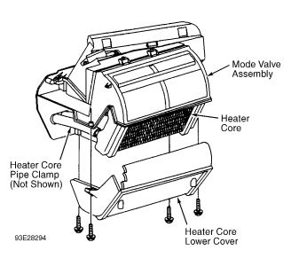

Just bought this car and drove it home. Noticed smoke eminating from between the firewall and the back of the engine when I popped the hood. Defroster only works when the A/C is on and blowing cold. Otherwise it fogs up the entire car. I also noticed some red fluid inside the car coming from the housing beneath the dash on the passenger side. Does it sound like a heater core problem or possibly loose hoses?? How difficult is it to replace the heater core??

HEATER CORE Removal Drain cooling system. Disconnect heater hoses. Remove lower trim panels from below A/C-heater control panel. Remove lower heater duct. Remove heater control cable. Remove heater core side cover screws and side cover. Remove lower heater core cover screws and pipe clamp. Remove lower cover. Remove heater core bracket and heater core. Installation To install, reverse removal procedure. Fill cooling system. Ensure control cables are properly adjusted. need manual CHECK IT @ https://www.2carpros.com/kpages/auto_repair_manuals.htm
https://images.2carpros.com/forum/automotive_pictures/99387_Graphic1_34.jpg
