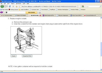

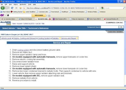

All I need to know is how to pull out the radiator and see what is wrong with it and then put another one in if need be. I just do not know how to take it out.
Thank you
Jul 21, 2010 at 7:11 AM
SATURNTECH9
  • 30,868 POSTS
https://images.2carpros.com/forum/automotive_pictures/416332_1995_sc2_radiator_replacement_part1_1.jpg
https://images.2carpros.com/forum/automotive_pictures/416332_1995_sc2_radiator_replacement_part2_1.jpg
There you go.

I have a question about radiators, I have a 96' sc2, and I'm trying to do a flush, but I can't drain it.. There's like a plastic wing nut or cocket, do you turn it clockwise or counter clockwise??
Aug 3, 2010 at 4:19 AM
SATURNTECH9
  • 30,868 POSTS
You would turn it counter clockwise with you facing it.You can follow the pin in the channel as you twist it to see that your turning it the correct way.
Aug 3, 2010 at 6:23 AM
TYLERT30
  • 9 POSTS
wat do you use to turn it tho, it is way too tight to undo it by hand, and there isnt enought room for pliers.. is there a tool you can use?
Aug 3, 2010 at 6:28 AM
SATURNTECH9
  • 30,868 POSTS
If it's a flat tab then you can use needle nose pliers for leverage.just be careful not to break it.
