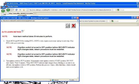

my ignition switch got stuck and would no longer start so i replaced the ignition switch with another and i wont start .the security feature has activated the passive lock feature and it wont go off what do i need to do? help

need scan tool to do the Passlock relearn procedure, best just to have local dealer do it .

https://images.2carpros.com/forum/automotive_pictures/416332_2001_SC1_pass_lock_relearn_1.jpg
Give that a try.I also emailed it to you so you can read it better.
