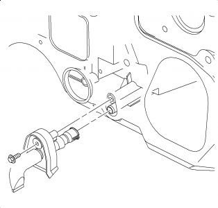

the drain is on the firewall behind the engine just use a screwdriver or pick to put in there to clean it out then watch out or u will get a bath if its clogged very easy to clean.let me know how it goes.[/quote:51083fa6cb] Thank you for the quick reply. I think I found the outlet but the nipple that points down is nowhere to be found. If that is the actual outlet then the missing peice has caused it to clog
https://images.2carpros.com/forum/automotive_pictures/488222_878155_1.jpg
It looks like the elbow of that assy. has come off. Thanks Chace

if u have a sc1 saturn then the pic u posted is wrong that pic is for a ls saturn the larger sedan there is no downward nipple on the sc1 let me know how the clearing goes.
