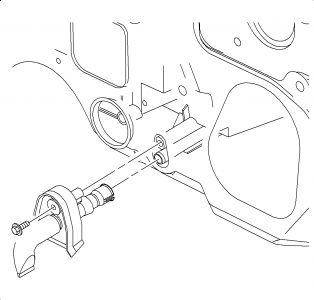

the drain is on the firewall behind the engine just use a screwdriver or pick to put in there to clean it out then watch out or u will get a bath if its clogged very easy to clean.let me know how it goes.[/quote:51083fa6cb] Thank you for the quick reply. I think I found the outlet but the nipple that points down is nowhere to be found. If that is the actual outlet then the missing peice has caused it to clog
https://images.2carpros.com/forum/automotive_pictures/488222_878155_1.jpg
It looks like the elbow of that assy. has come off. Thanks Chace

if u have a sc1 saturn then the pic u posted is wrong that pic is for a ls saturn the larger sedan there is no downward nipple on the sc1 let me know how the clearing goes.

yeah wrong picture sorry. i tried shoving weedeater line in and got about 7 or 8 feet before I gave that up but the line had zero moisture on it and no water came out.
this outlet is right above the exhaust pipe and comes straight out of the center of bulkhead(and sticks out about a 1/2 inch. If that isn't the drain outlet, then I have no clue where it is.
