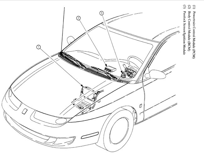

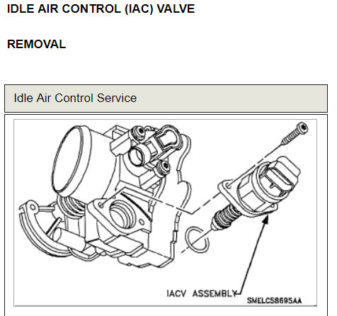

JORDAN MYRICK TURNER
I have a 1997 Saturn SL1 very high idle. It will go by itself over second year idles at about 3,000 rpm's. I am wondering what should I do before going and just buying the air intake valve? Please help.
Jun 9, 2018 at 4:40 AM
  • 54,840 POSTS
Try the valve first and if that does not fix it I have seen the PCM cause this issue. Here are two guides and diagrams below to help you get the problem fixed.
https://www.2carpros.com/articles/engine-idles-too-high
and
https://www.2carpros.com/articles/how-to-replace-an-idle-speed-control-motor-iac
Here is the locations for your car (below). Please run down these guides and diagrams and report back
Jun 11, 2018 at 12:48 PM
